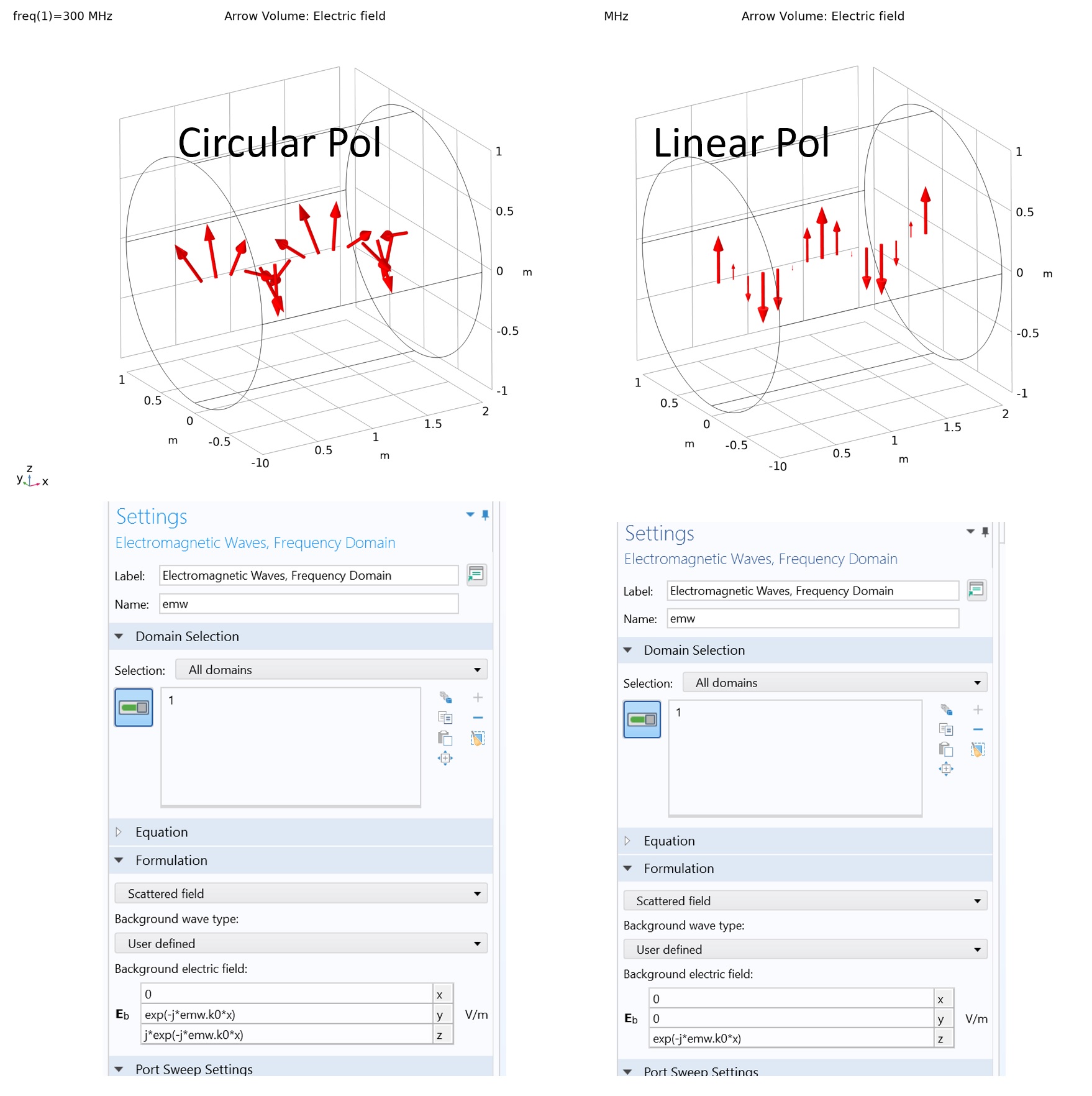

This is straightforward to do. See the attached picture, which shows x-directed plane waves and how they were specified. One is CP and the other is LP.

Thank you sir, Actually I want to incident the LCP or RCP at 30 degree angle of incidence. So from where should i put that angle of incidence thing. Because in the background electric field, where i put the equation, there is no option for controlling the angle thing. Can you please enlighten me ? Thank You

You can specify the individual vector components of the wave. With a little thought, some pencil and paper, etc., you should be able to see how to specify kx, ky, kz, and Ex, Ey, and Ez.
(Trust me, you'll never regret practicing your vector analysis.) :) Alternatively, you can keep the wave going along an axis, but simply rotate your whole problem geometry (but that's the quick/lazy solution).
You can specify the individual vector components of the wave. With a little thought, some pencil and paper, etc., you should be able to see how to specify kx, ky, kz, and Ex, Ey, and Ez. (Trust me, you'll never regret practicing your vector analysis.) :) Alternatively, you can keep the wave going along an axis, but simply rotate your whole problem geometry (but that's the quick/lazy solution).
