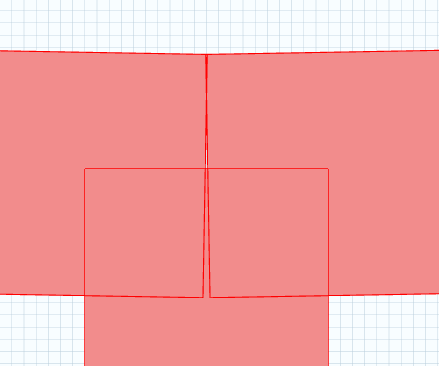

I have a model essentailly made up of a number beams connected together and then 'union'ed together to form the whole and extruded into 3D.
The problem i have is that sometimes a smal,..sliver of a gap remainswhere some beams look to join which then leads to COMSOL throwing a fit in a number of places :).
Anyone happen to know of a way to get Comsol to fill the gap so to speak. I thought repair might work but it does not seem to do anything high or low value.
I attatched a small example pic.
Any help is appreciated.
Regards Mike F

Mike,
If you are only interested in the final outside dimension (not the internal domains). Then I would extend the lower rectangle upwardsto cover the gap left by the other two shapes.
I would then form the union and then delete internal boundaries.
Regards,
Tom
Mike, If you are only interested in the final outside dimension (not the internal domains). Then I would extend the lower rectangle upwardsto cover the gap left by the other two shapes. I would then form the union and then delete internal boundaries. Regards, Tom

Sadly I can't do this manually,
The design is essentially part of a stochastic design optimisation process, and as a result I have no control over the design.
Essentially the process overrides certain parameters of a default design to create a new one. I just wondered if Comsol had a process which could be called which might be able to 'repair' these little niggles :).
Regards MF
Sadly I can't do this manually, The design is essentially part of a stochastic design optimisation process, and as a result I have no control over the design. Essentially the process overrides certain parameters of a default design to create a new one. I just wondered if Comsol had a process which could be called which might be able to 'repair' these little niggles :). Regards MF

Have you checked out the ConvertToSolid, ConvertToSurface, ConvertToCurve, ConvertToPoint functions. They are described in the COMSOL API documentation.
Tom
Hi, Have you checked out the ConvertToSolid, ConvertToSurface, ConvertToCurve, ConvertToPoint functions. They are described in the COMSOL API documentation. Tom
