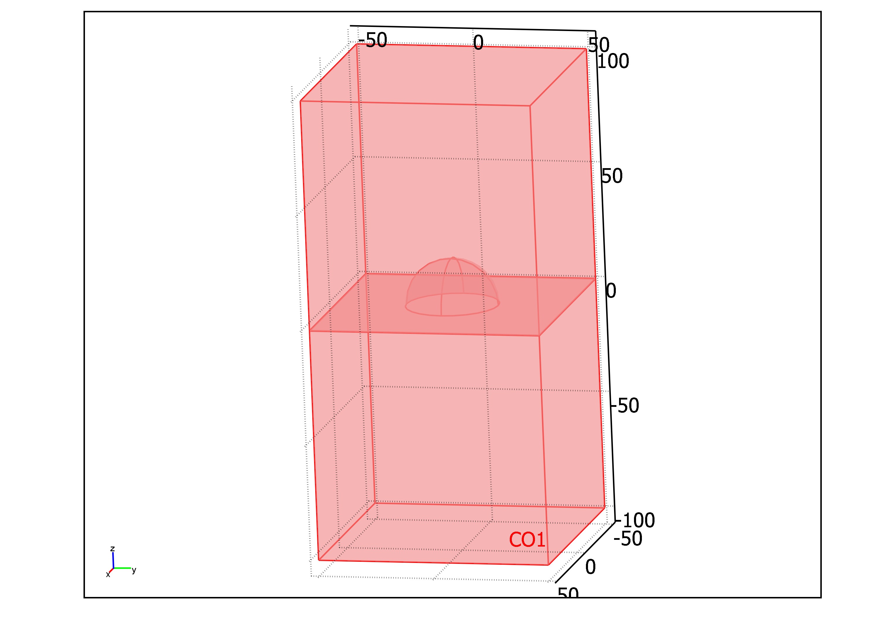

Hi - not sure this works, but if I understand you right, you should be able to define a 2D mesh on the internal boundary between the hemisphere and the plate, respectively, the face of the thin plate with the hole in (using Free Mesher/Boundary). Now you should be able to mesh the thin plate with the swep mesh. The Free Mesher should now work on the hemisphere.

Hi, K.P.
Thank you for your reply.
As you mentioned, it is true that I can mesh the interface between two objects, but, the interface belongs to the thin plate will definitely has a hole, and it did not work when I try to use the "swept mesh".
Currently, my solution comes from a poster here named "mesh a thin plate" or something similar.
I divided the thin plate into at least two pieces-- a plate with a central hole and a central part whose surface is exactly equal to the bottom of the hemisphere. In this case , I can use the Swept mesh with no problem.
But, I made the central part by extruding the 2D circle, and I found the edge of circle is not consistent with the edge of 3D shpere well, or I should say rather rough.
These un-matched interface will lead to the inverted mesh element at their edge and a warning accured after all the calculation.
Does anyone meet the rough 2D problem before?
Hi, K.P. Thank you for your reply. As you mentioned, it is true that I can mesh the interface between two objects, but, the interface belongs to the thin plate will definitely has a hole, and it did not work when I try to use the "swept mesh". Currently, my solution comes from a poster here named "mesh a thin plate" or something similar. I divided the thin plate into at least two pieces-- a plate with a central hole and a central part whose surface is exactly equal to the bottom of the hemisphere. In this case , I can use the Swept mesh with no problem. But, I made the central part by extruding the 2D circle, and I found the edge of circle is not consistent with the edge of 3D shpere well, or I should say rather rough. These un-matched interface will lead to the inverted mesh element at their edge and a warning accured after all the calculation. Does anyone meet the rough 2D problem before?

When I see your jpg, my first question is cannt you transform these cubes into cylinders?, so that you can use 2D-axi and get rif on one DoF.
If not, then I would split the parts into 4 symmetric items, using the split lines of the hemisphere. there are then 2 ways out.
Either the case is symmetric so one can work with symmetric/anti-symmetric boundaries and mesh only 1/4 of the problem.
Or, to work in full 3D. By having split the volumes, it is easier to apply a sweep mesh.
By the way a sweep mesh can be defined manually from ONE or SEVERAL starting surface(s), but then ending on only ONE opposed surfaces, allowing a simple projetion. I agree there are severe limitations in the topology to get it meshing by the sweep function, some excercices are often required.
Hi When I see your jpg, my first question is cannt you transform these cubes into cylinders?, so that you can use 2D-axi and get rif on one DoF. If not, then I would split the parts into 4 symmetric items, using the split lines of the hemisphere. there are then 2 ways out. Either the case is symmetric so one can work with symmetric/anti-symmetric boundaries and mesh only 1/4 of the problem. Or, to work in full 3D. By having split the volumes, it is easier to apply a sweep mesh. By the way a sweep mesh can be defined manually from ONE or SEVERAL starting surface(s), but then ending on only ONE opposed surfaces, allowing a simple projetion. I agree there are severe limitations in the topology to get it meshing by the sweep function, some excercices are often required. Good luck Ivar
