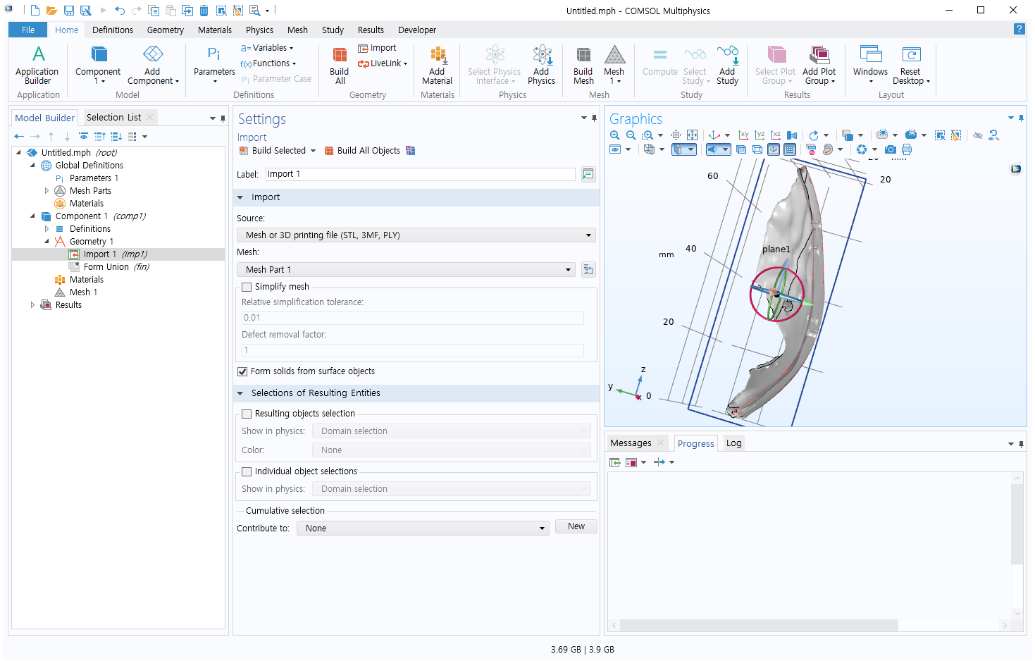

Hi, I imported .stl file in COMSOL in geometry panel, and I checked 'form solids from surface objects' to make it solid body.
Command lines showed are as below: [Oct 19, 2021 3:17 PM] Finalized geometry is empty. [Oct 19, 2021 3:21 PM] Imported 1 solid object from D:\Documents\urp\ct\1015\monkey_1015 v0.stl via Mesh Part 2. [Oct 19, 2021 3:23 PM] Imported 1 solid object from D:\Documents\urp\ct\1015\monkey_1015 v0.stl via Mesh Part 3. [Oct 19, 2021 3:23 PM] Finalized geometry has 1 domain, 211 boundaries, 2310 edges, and 2101 vertices.
When I cut the model in half with clipping, the cross section was empty. I want it filled since I am going to have ultrasound propagation simulation through skull. Is it already filled(since it's a solid), if not, how can it be fixed? Thanks in advance.

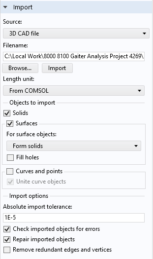

It sounds like you will need to use the Geometry tools in Comsol to fix some gaps that are preventing Comsol from recognising your imported Geometry as a solid. It is difficult to give any specific fixes. I assume you have the import settings as shown in the attched image?

I imported a stl file like below: and it also looks like a surface, not solid.
I changed the setting like you attatched, but the error message shows: "Unrecognized file type"
I imported a stl file like below: and it also looks like a surface, not solid. I changed the setting like you attatched, but the error message shows: "Unrecognized file type"
