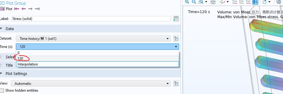

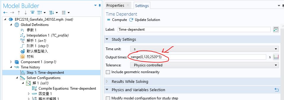

Thank you Magnus. You cleared my confusion. May I ask if I want to take advantages on the solution from step 1 to get results of the increased time steps, what will be the right approach? My goal is to save the time for comsol to get an initial solution, which seems to take the most of the time. Is there a blog or reference I can learn from? Thank you!
