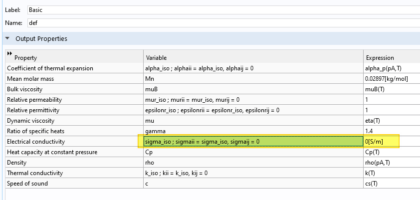

In some cases, you should not set the conductivity to zero. In others, you may do so. You didn't mention which physics configuration you have chosen. Here is a related discussion: https://www.comsol.com/forum/thread/285781/Magnetic-field-created-by-a-DC-wire

Oh, thank you so much. I'm using Thermoelectric Effect modus. I think I made a mistake, just the non-triangular element is 0. Thank you for your explanition.

I'm not familiar with the Thermoelectric Effect module but I do know that the Magnetic Fields (mf) module (magnetic potential formulation) is just fine with resistivity of air being zero. At the same time, the Magnetic Field Formulation (mfh) module (H-formulation) is not. It depends on how the Maxwell equations are solved and whether they use conductivity or resistivity variables. If your simulation is running with conductivity of 0 and producing results then it's all good. If it isn't you will never converge at all.

It would be interesting to get a more in-depth description of your model, or better yet, your mph file and a description of what you are trying to achieve with the model.
I am saying this because there is also a chance that you should not even be including the region occupied by air in your EM physics.
