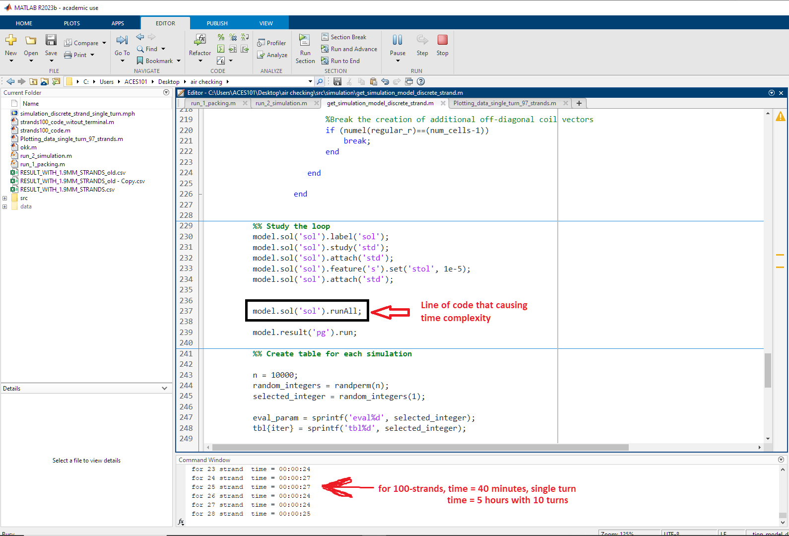

I am simulating coil strands to know its AC resistance. i am using LiveLink for MATLAB to automate this task. however, for 10 turns coil with 100 strands, the total simulation time goes to 5 hours while for 10 turns with 300 strands, the total simulation time goes 50+ hours. by profiler code checking, i found that *** model.sol('sol').runAll;*** is taking 95% of overall simulation time. can you please suggests me to reduce the time duration of simulations. I am using regular mesh with minimal complexity. best regards thanks

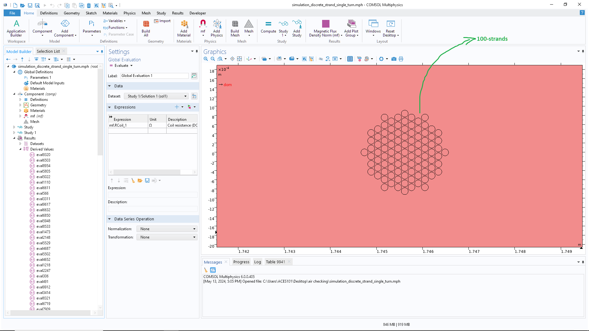

Be aware that some problems are just too big.
However based on your drawing it looks like you have six-fold symmetry. Use it.
Be aware that some problems are just too big. However based on your drawing it looks like you have six-fold symmetry. Use it.
