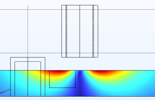

I'm pretty new to COMSOL but have been required to use it for an assignment, so I'm not fully aware of how to problem solve when I get strange things happening like this!
I am building a model using the AC/DC module with frequency domain analysis. I have a homogenised coil with many turns situated above a 1.5mm layer of CFRP, then underneath that there is a 3mm layer of Aluminium. The aluminium layer has a cuboid region cut out of it, which one half of the coil is located above. The cuboid region was created by subtracting a cuboid from the plate, which then leaves a region that isn't allocated as aluminium and therefore defaults to air. I have double checked and the region is indeed air and is not overriden by any other material.
However, the Eddy currents produced in the Al layer are clearly just flowing straight through this air region as if it wasn't there and it was all just part of the Al sample. In the screenshot attached, the slice runs directly through the centre of the coil and air region, which is the square directly under one half of the coil. It clearly shows the current just flowing straight through it, which isn't physical. The "n-shaped" object to the left of the air region is a Ti rivet, which should also have some impact on the current, but it doesn't seem to.
It looks like COMSOL is considering the entire sample to just be one solid block of conductive material, but I've checked and double checked my material assignment and I can't see why this should be the case. Can anyone offer a possible solution please? Thanks in advance!
The COMSOL version I'm running is V6.2.

I added an Ampere's Law node that overrides all the Free Space assignments and set the conductivity for air and the dielectric to 1 S/m for solver stability. Now the result looks realistic.

The reason for the lack of material contrast, is that everything is free space. Adding materials to the model gives COMSOL access to the necessary material data, but it does not specify how to treat the domains. In the physics, the default node is "Free Space" (vacuum/air), this node serves as a canvas. You can add an "Ampère's Law in Solids" node to indicate that your metals are solid (basically; what Edgar says -- see attached).

The Free Space is the default domain feature in the Magnetic Fields interface since version 6.2. It is there to automate the modeling of free space (non-conducting media with relative permittivity and relative permeability of unity). Depending on the frequency, some artificial conductivity is needed in such domains and the Free Space feature is there to automate that.
The Free Space feature must be overridden by the user in domains having a (non-free space) material by adding Ampère's Law in Solids or Ampère's Law in Fluids - otherwise the entire simulation domain will be treated as free space.

When adding Ampère's Law in Solids to your non-air domains (above the Coil as the Coil also overrides Free Space and is overridden by Ampère's Law in Solids), the solver warned for some missing material properties in the CFRP_homogenised material (permittivity and conductivity) so I added, hopefully intelligent, guesses for those see the attached version.
