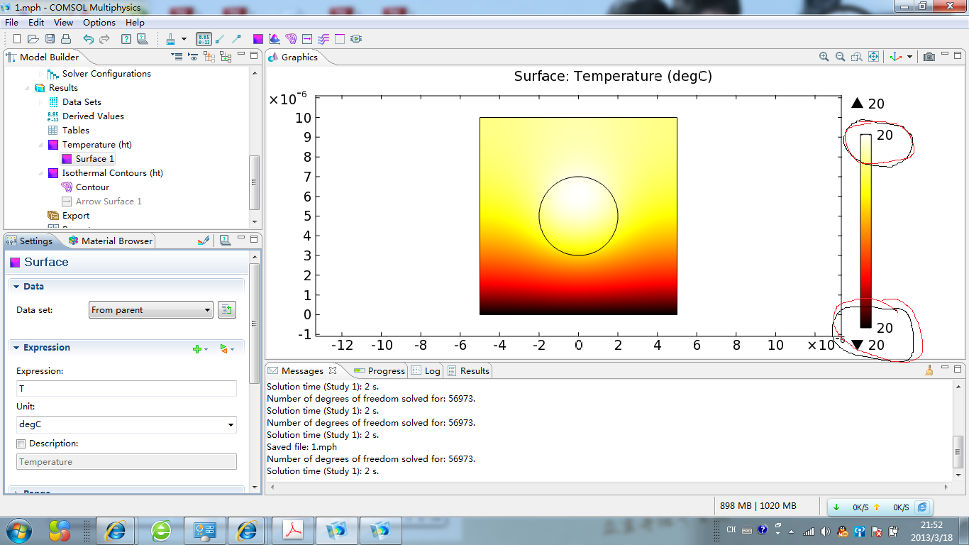

In a 2D model, the bottom is heat sink at 20 degrees. The other 3 boundaries is themal insulation. Then a heater is at the center. I can't get the right result. The temperature is uniformly 20 degrees within the boundaries, not a right temperture distribution.
I don't know why.
Hi Ivar, I also meet the similar problem. I am confused on the Heat source. In a 2D model, the bottom is heat sink at 20 degrees. The other 3 boundaries is themal insulation. Then a heater is at the center. I can't get the right result. The temperature is uniformly 20 degrees within the boundaries, not a right temperture distribution. I don't know why.

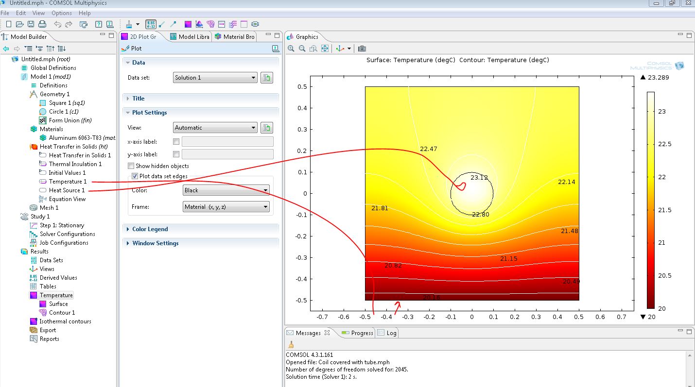

is this what you try to do ? its 4.3a
Hi is this what you try to do ? its 4.3a -- Good luck Ivar

Yes, If the heat source is set to Total power, I can get the result iin your attached figure.
But if the heat source is set to General source or Linear source, I can't get the right result.
See the attached, with "General source" setting.
I still do not know why?
PS: I am with 4.2 version.
Hi, Ivar, Thank you for your help. Yes, If the heat source is set to Total power, I can get the result iin your attached figure. But if the heat source is set to General source or Linear source, I can't get the right result. See the attached, with "General source" setting. I still do not know why? PS: I am with 4.2 version.

if its a general source you have other units, have you checked the energy flow, you see the gradients there in your image, it's "just" that your energ/powery in versus energy out ratio is not enough to give a huge temperature difference in steady state
That is my explanation at least, might be other things too
In anycase have you checked the simple analytical formulas, or looked at the total energy/poewer in versus out = energy balance of your steady state model there ?
Hi if its a general source you have other units, have you checked the energy flow, you see the gradients there in your image, it's "just" that your energ/powery in versus energy out ratio is not enough to give a huge temperature difference in steady state That is my explanation at least, might be other things too In anycase have you checked the simple analytical formulas, or looked at the total energy/poewer in versus out = energy balance of your steady state model there ? -- Good luck Ivar
