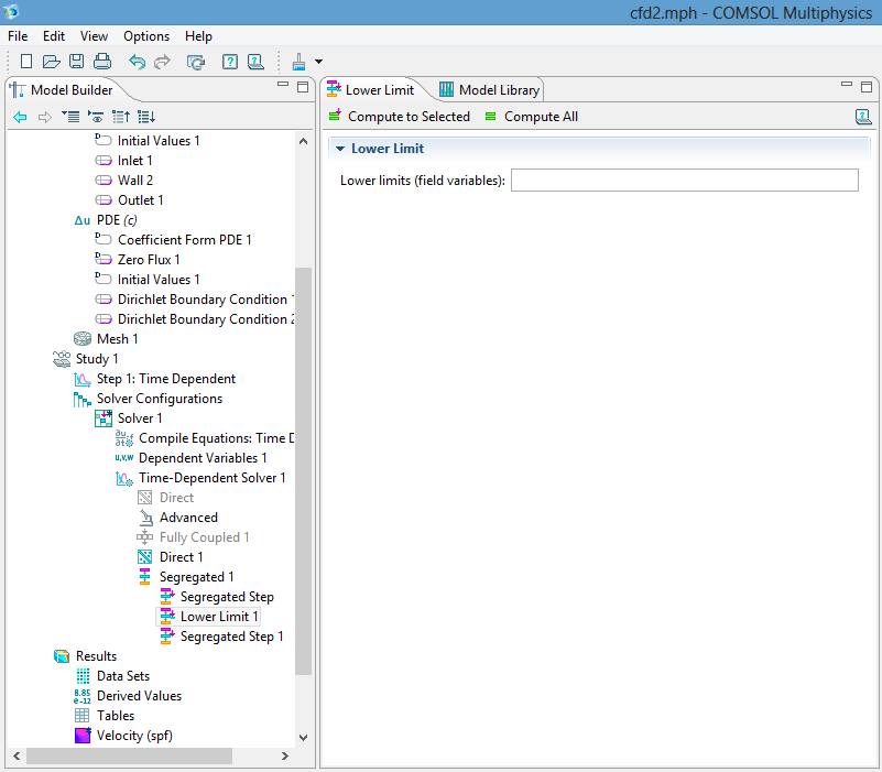

I'm trying to use the lower limit node, but I can't select any variables because the variables window is not there. I can select variables in the segregated step nodes. See attached file for screenshot.

If your variable is u1, and the lower limit is 0.5, then write like this:
mod1.u1 0.5
If you want to set two limits, then write:
mod1.u1 0.5 mod1.u2 0.5
